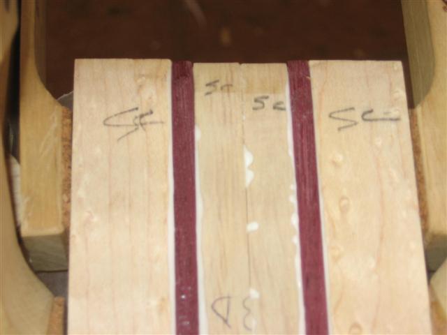

I just made some necks out of birdseye maple and of course it's laminated too. Tell me what you think of this combo for a bass neck? TIA I have some 1/8 by 3/8 carbon fiber coming along with the flat-topped rod you recommended from LMI.

Bruce looks good to me. I've used purpleheart for a center stripe on walnut and mahogany guitar necks with good results. As a longtime bass player, I got into this hobby by modifying and building bass guitars. I need to build an outlandish neckthrough. mabe it's time for a new project.

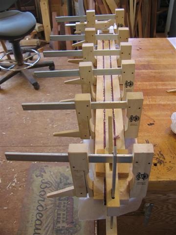

BTW, Bruce, I would want a helluva lot more clamping power on a neck blank
like that.Howard Klepper38824.5530208333

Howard, you are right, I needed just a bit more clamping on the Hornbeam center. Otherwise I got good even squeeze out on the layup. The hornbeam being first had pretty much dried up and didn't give me the squeeze-out I like. Live and learn.
My normal necks get a whole bunch more torque, like this:

It's good idea to remember when you are clamping a laminate that your
force is being distributed over all the joints. So, for example, in the photo
above, if each blank is a three piece, you are clamping eight glue joints at
once. What would be a lot of clamp for one neck blank with two joints may
not be a lot when you are dividing the pressure by four. Franklin
recommends something like 150-175 psi clamp pressure for Titebond.
That is probably overkill, but do the math and you will see that you have
only a fraction of the recommended amount, even with a heavy-duty looking
setup like the above. Probably OK, but not as much pressure as it first
appears.

[QUOTE=Howard Klepper] It's good idea to remember when you are clamping a laminate that your
not be a lot when you are dividing the pressure by four. [/QUOTE]
The force of the clamps IS distributed over the gluing surface, so, to get the pressure, you should divide the total clamping force by the gluing surface of each joint (any one of the joints, since they all have the same area)
But, it doesn't matter how MANY glue joints you have, if they are all stacked up, like the picture here.
The force that the clamps are applying is seen by all of the glue joints. Each joint sees the same force and that equals the force that the clamps apply. You don't have to divide by the number of joints.
Think of it this way - if you had 10 short ropes tied together into a long rope, and pulled on the long rope with 10 pounds of tension, each of the short ropes would see the same tension - 10 pounds (not 1 pound each)
Phil

Phil, I think you are right. I thought about it this afternoon and it came up
the same way--the pressure should be transmitted through the material.
My mistake.
